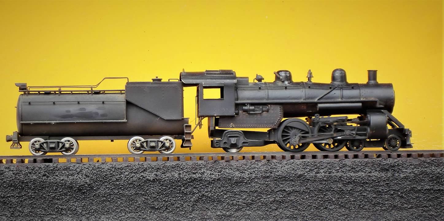

I am going to repeat Jim's Atlantic, then post an All Nation sort-of stock version. Let me see if this works:
Posts: 13676
Re: Machine Shop / Locomotive Drive Work
Postby bob turner » Wed Oct 26, 2022 9:12 pm
Yes, it worked. I am not a great fan of the All Nation models, except for the Mountain, but I have one of each, in various forms of disarray and modification. I think this one could be saved with an extended firebox, new cab mounted slightly further aft, and a new smokebox wrapper extending that part forward maybe 1/8" or so. The taper is correct for the TNO class A-2, but you can see that Jim's model has a far more graceful appearance.
Not going to tackle that tonight - I pulled out the SE-3 and may add running boards. It runs, but is currently pretty ugly.

Here is a different view of the comparison that Bob made above regarding the two Atlantics:
I flipped Bob's photo 180 degrees, so what looks like the engineer's side is actually the fireman's side. This view makes it easier (at least for me) to see the differences, which are many.
I took calipers to the drivers of the T&NO model today. They measured out to 70", which is a bit smaller than the 73" of the prototype. The drivers on the model appear to be stock, but I didn't think to check them against the one and only other GMC-All Nation model I own (an articulated).

All of the AN drivers are 70", from the American through the articulated. The counterweights are B&O ten wheeler.
I decided to work on it a bit. First step will be extending the smokebox, possibly as much as 3/8". That will allow me to re-drill the forward cylinder mounting screw and stack holes in new metal, and will move the firebox aft 1/8".
Then new firebox sheets. One side has the reverser cast in, and I will leave it that way (doorstop heritage, right?).
It will get a new cab, which will look a lot more like Jim's, but I am going to copy the cab from a prototype photo.
And finally, it will get new dome tops, more in keeping with SP contours. I may re-do the cooling coils, but not until I see if I can create the grace of the A-1. Oh, and it will get a boiler belly. Mine already has 72" drivers (Lobaugh). They fit right in the AN frame, even though I generally recycle those in favor of 1/4" brass plate.
Thanks! Makes it lots easier to compare.

First step is done - extending the smokebox dramatically changes things.
There are limits to making doorstops more realistic - lots easier to start from scratch.

Postby bob turner » Mon Nov 07, 2022 2:44 pm
I am stopping here - needs a new cab, stack, headlight, and lots of piping/appurtenances. But I am going to mess with the SE-4 0-8-0 for a while.

R.K. Maroon wrote:Here is a different view of the comparison that Bob made above regarding the two Atlantics:
You know, personally I have never liked the 4-4-2's. Just look...unbalanced. Maybe it comes from the disaster of a Half 0 Roundhouse I had 60 years ago.
But that second one makes me re-evaluate my ideas on 4-4-2's. That one looks more "balanced", drivers more centered under full boiler.
