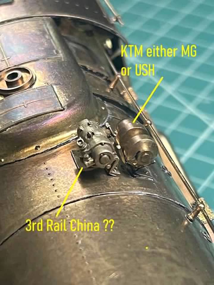

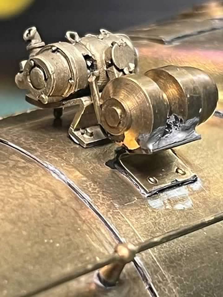

Just sharing my delight in one 3rd Rail casting and showing why I'm upgrading my KTM FEF-3. All the castings from the donor model are just as crisp and detailed. Sadly my photographic skills are not as crisp.
I realize the KTM steam generator is coined not cast and is 50-60 year old technology.

Thats not a KTM part. KTM dynamos are as detailed as the one on the left. I don’t have any Max Gray O scale but that appears to be a turning rather than a casting.

I agree with Pete. All my USH/KTM FEFs have a generator that looks nothing like one in your picture.
The solder joint also hints at it being a replacement part someone’s used in the past, the USH joints were for the most part “clean”. This one is clearly not. Or, it’s not solder at all, possibly epoxy..
It’s not a PSC “replacement” part either, I have several of those and none look like that.
Oh well, it’s just another opportunity to add a correct part since you’re this far into it!

You guys are absolutely right.
After posting these photos, it struck me as odd to see a turned or coined detail on an early brass model. So, I went online looking for examples of other MG and USH locos....especially the FEF. I found this same steam generator on several MG locos including the listing below for a NKP 2-8-4. I also went to my KTM/MG spotters guide (Duh, I should have done that first) and sure enough on pg. 30 this generator is shown on the FEF3.
My bad, but it confirms beyond a doubt that my model started life as a MG and has an added USH gearbox and drive and someone added a can motor as well. When I bought it from Si Simonton in the late 90's he told me it was updated model, but I can't remember what all he told me.
