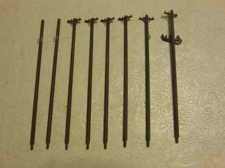

I am in Erie, PA taking care of my parents over the long weekend. I finally got a chance to do some modeling work today and managed to get 8 telephone poles pretty close to completion (they still need some putty & touch up paint). I have 2 others in progress with some work to do on the transformers (the one's I cornered the market on, John :lol: ). Here are some photos.

I see why you had a problem finding them.
I don't think those short cross arm poles were very common.
Looking good.

Postby G3750 » Mon Jan 20, 2014 11:22 pm
rogruth wrote:I see why you had a problem finding them.
Looking good.
Roger,
Thank you! These are the Weaver telephone (or line) pole kits originally designed by my friend Neal Schorr. The cross-arms have up to 10 insulators each and you can have 4 cross-arms. I just clipped the arms to make them shorter (4 insulators) like the prototype. I will fill in the remaining holes on the shaft of the pole and paint and Dullcote them.
Postby G3750 » Mon Jan 20, 2014 11:23 pm
Berk765 wrote:Those polls look great. :)
Thank you, Berk! Building them from the kit is not too hard. Deciding what each should look like has taken the most time. :wink:
Postby rogruth » Tue Jan 21, 2014 12:14 am
I assume you looked at the ones from Weaver.
They looked nice but you would still need to cut the cross arms.
Postby G3750 » Tue Jan 21, 2014 6:44 am
rogruth wrote:I assume you looked at the ones from Weaver.
Yeah, the ends were cut with a sprue cutter. It made a neat cut, which I dressed with a file and will touch up with a little paint.

Postby jlong » Tue Jan 21, 2014 9:25 am
He said they are Weaver. Walthers is just a distributor.
