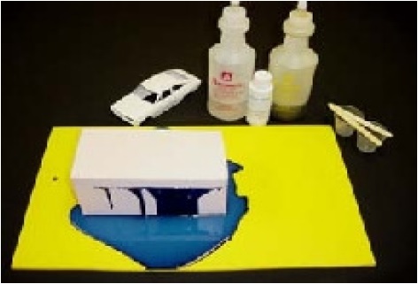

What is a "squish" mold?
Posts: 15419
Re: From the Firefly Shops.........
Postby webenda » Mon Oct 09, 2017 4:11 am
Common molds have pour gates and vents. They are filled with resin after the two halfs of the mold are put together by pouring the resin into the pour gate holes(s).
Squish molds are filled by pouring an excess of resin into one half the mold then assembling the other half of the mold, squishing the excess resin out during the assembly (putting the two halves of the mold together.)
Blue Resin Squished out of Squish Mold.jpg (34.45 KiB) Viewed 14733 times

webenda wrote:Squish molds are filled by pouring an excess of resin into one half the mold then assembling the other half of the mold, squishing the excess resin out during the assembly (putting the two halves of the mold together.
And with a very little bit of practice and learning just how much resin to put in the 1 half. there is then very little excess to squish out.
While the vented molds are useful, the basic squish actually can be more efficient to use for some shapes that would otherwise trap air and ruin the casting.
