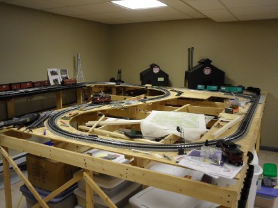

First photo shows the mainline as it approaches Weirton Junction from the bridge. That is all in place and awaiting test running. If we need to, additional track screws and shims will be installed to make the line absolutely smooth for those engines with scale pilots.

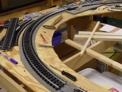

The second photo shows mainline curve west (railroad east) of Weirton Junction being placed.

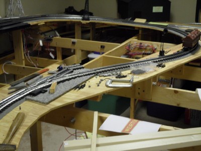

The final photo shows the completed line powered up (lit cabin car). I used the N8 to test power over the entire repaired length. Next step is running trains and testing.

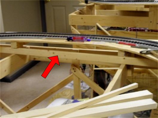

Postby G3750 » Sat Jun 02, 2012 11:18 pm
Bracing Photos:
I fixed the photos to show the new bracing I added. The red arrows indicate the additional support.
This shot is taken from under the layout and shows the long 1"x2" that holds up 2 subroadbed cleats on a long curve.

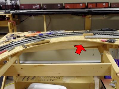

This photo actually show two braces (although only 1 is highlighted by the red arrow). That brace supports the switch at Weirton Junction (extreme right edge) and flows left to the brace shown in the first two photos.
Brace 0061W.jpg (20.2 KiB) Viewed 8756 times
Postby G3750 » Sun Jun 03, 2012 10:23 am
Please take a look at the previous post. I fixed the photos to better illustrate the new bracing.
Postby Roy » Sun Jun 03, 2012 10:48 am
G3750 wrote:...Way earlier in this thread suggestions were made about creating a "T" with the bracing piece and the subroadbed. I have used that to add rigidity to the affected areas...
George, I need to clarify. The top of the T is the plywood underneath the track. By putting cleats in between the two parts of the T, you have lost the continuous support the T form gives.
I'm telling you this, for future reference. In any event, I hope your efforts prove fruitful.
Postby G3750 » Sun Jun 03, 2012 11:48 am
You are absolutely correct, Roy. The brace shown in the first two photos only provides a marginal increase in stability. I did that because I happened to have a piece of wood that fit and it did help a little bit. Plus that part of the roadbed is already pretty stable.
The approach shown in the 3rd photo is the one you described and the one I intend to pursue for other parts of the layout.
