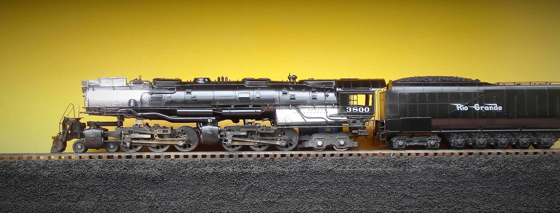

Here is a Lobaugh Challenger I am quite proud of - Lobaugh made Challengers in the prewar period following the UP Fetters design, with slight modifications for the Northern Pacific and Delaware & Hudson locomotives. I have an original D&H, but used UP parts to make my NP version.
Both the D&H and NP models had incorrect tenders - aspect ratios were seriously "off". I cured the D&H by adding about a scale foot to the bottom of the original sides and ends. I did an all new tender body for John Fisher, many years ago. I don't remember what we did for Maroon's version.
The NP shown here is unique in that both engines are separately powered, with the front driveshaft going straight through the rear shaft. Twin motors are mounted vertically in the firebox. Delrin chain is used for the drop-down, but it is too noisy - someday a tooth belt will go in there.
Oh - and the tender is a wood block. I do have the correct Commonwealth trucks for it, but what you see is what Lobaugh used. The Lobaugh tender was almost an inch shorter, so it sort of fit the shorter Lobaugh castings.

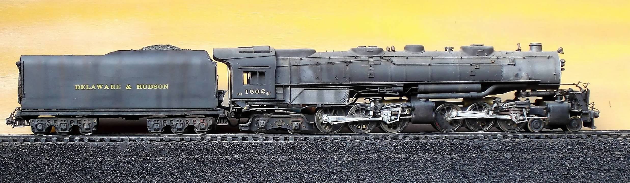

Here is the D&H - this one was only available before WWII. It came to me from Frank Thompson (RIP) of Philadelphia. UPS kinda smunched the cab a bit, and agreed to pay me $125 to fix it.
The tender is genuine Lobaugh, but raised up to match D&H drawings, instead of Lobaugh drawings. It came to me cut up pretty badly for USH gearboxes, but I added metal to the frames, made all axles come out the bottom, and returned it to genuine Lobaugh gears.
If Maroon doesn't post his D&H again, I think I have a photo or two.

Here at Bob's request is a reprise of the "Woody" D&H Challenger.
First, here is how the locomotive was first spotted, sitting on Woody Mathews's layout in Seattle:
https://dl.dropbox.com/scl/fi/im35yaedqyl1dfkmyl71t/Lobaugh-D-H-Challenger-At-Woody-s.jpg?rlkey=8utrlf8kcggyxd18mnot9igqr
Here is how it was listed at auction:
https://www.dropbox.com/scl/fi/uekxgoexxyge179uqv7da/Lobaugh-D-H-Challenger-As-Auctioned.JPG?rlkey=s6ya6lika4ai0pbz31oosglti
Here it is after Dave picked out all the lead shot and Bob completed the salvage and rebuild operation:
https://dl.dropbox.com/scl/fi/kov7vq34zx86d01s5lgbx/Lobaugh-D-H-Challenger-Restoration-06.JPG?rlkey=98lhssnh4qnrsvx468qrd83r0
Here it is after Pete and I finished with it:
https://dl.dropbox.com/scl/fi/t4u99j9z6gb7omtdcq0iz/Lobaugh-4-6-6-4-D-H-1523A.png?rlkey=9w7niyxksy5vqj41uptnbjjzh
And, finally, here it is in operation on Brady McGuire's layout in Sherman, Texas:
https://dl.dropbox.com/scl/fi/0kg5er9xf9kgg0lqmi5bx/D-H-Challenger.jpg?rlkey=gml83dp8nl4v74j9p82d0s47c
It's a smooth runner and solid puller. I have acquired a D&H caboose so hopefully video will be forthcoming sometime "soon". I guess it's a good thing that there is always more video to shoot.

Re: Lobaugh Challengers
Seen like this, that is an incredible transition...Wow! I guess it's true.....many hands make the work go easier. Seriously, that is a beautiful loco and a super journey to see in photos.
As it was it made a good model for a very minor boiler mishap and would have looked good sitting outside a roundhouse. BUT, it looks super now.
