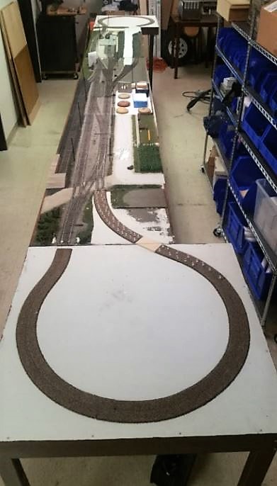

We wanted to run continuously and debated adding either balloon tracks with one main track across the layout connecting them or loops at each end with two main tracks across the layout. We settled on the second idea, and with the plan finalized proceeded to build end-loop modules. Here is one end:
And here is the other:

Thanks, Jay -- The effort to get the new end loops built and tied into the existing models for our new-old traction layout is driven by a commitment our club made to setup and run the layout at a local "history week" model train exhibit at the depot in Allen, Texas (far north suburb of Dallas). We started the project eight weeks before the show. The previous photos were from weeks 1 and 2. Here is the progress after week 3:
West end looking east:
West End Looking East.JPG (97.34 KiB) Viewed 14780 times
East end looking west
East End Looking West.JPG (80.35 KiB) Viewed 14780 times
Most of the cork is down, except for a stretch on the legacy layout where a siding got pulled up to be regraded and converted to the main line.
Week 4, which was this last Saturday, next. Note that we don't have illusions that we can get the overhead wire up in time for the show. We plan to run as a 2-rail operation for now. We have smattering of short equipment -- industrial switchers and the like -- so we should be OK. Those are 15" radius curves. It will be interesting to see what runs and what doesn't.

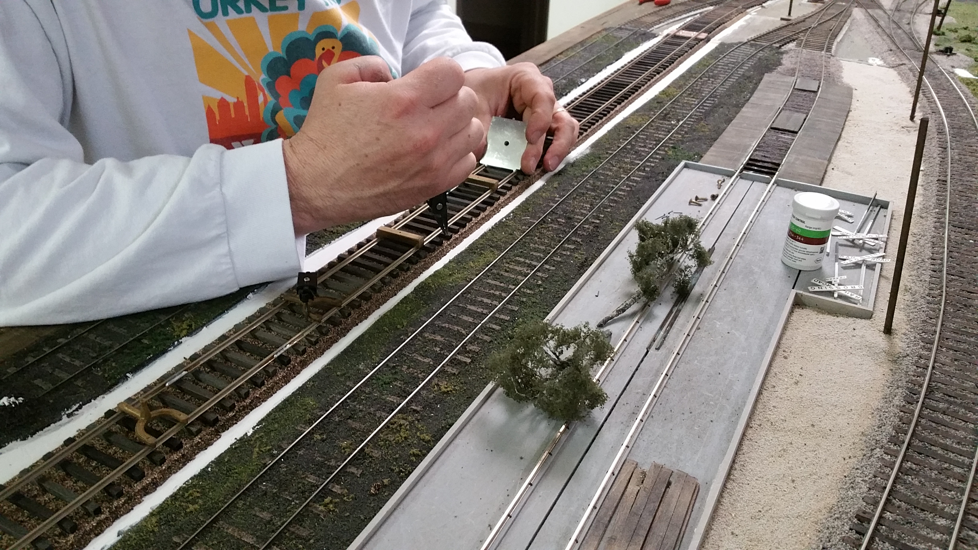

Last Saturday was week #5. All the ties are down and the rail has been bent. The spiking of track is well under way:
Spiking Track 01.jpg (2.29 MiB) Viewed 14733 times

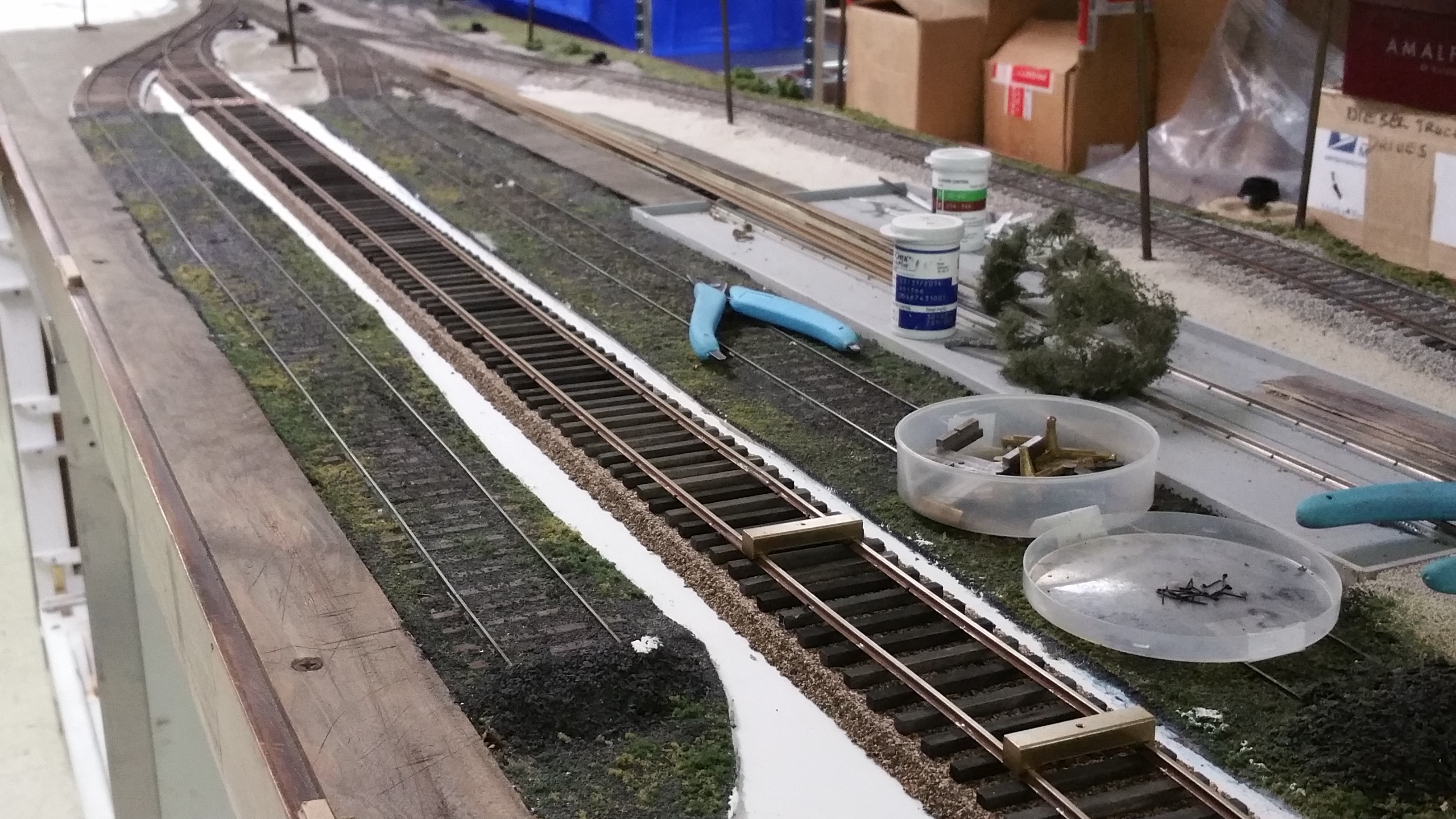

This straight section was a spur on the legacy modules that we are converting to mainline. Notice the cork to raise the roadbed and the code 125 rail. The spurs are otherwise code 100 at grade:

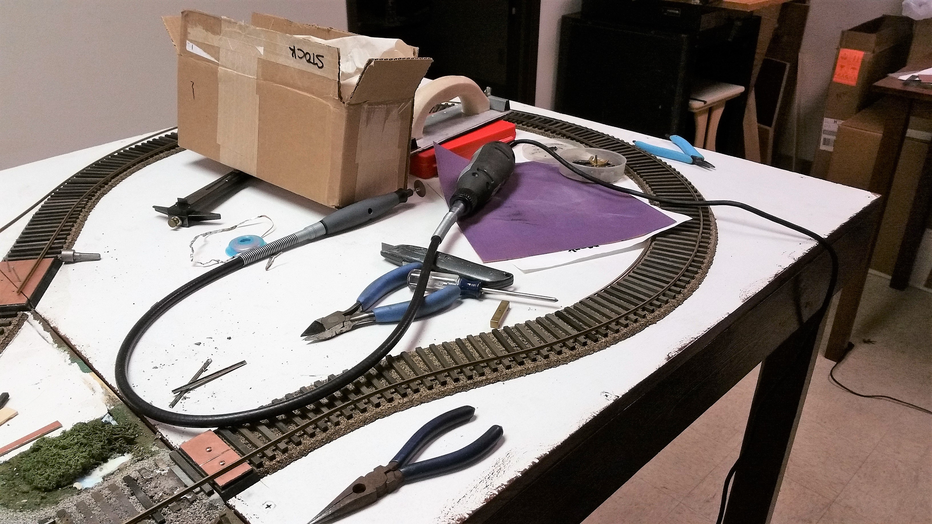

This looks like a mess but it's actually the outside rail getting spiked down on the east end-loop:
Spiking Track 03.jpg (1.79 MiB) Viewed 14733 times
Prebending the rail is really helpful when the radius is this tight. It takes some back and forth to get the rail bent more-or-less correctly, but it sure makes spiking easier.
