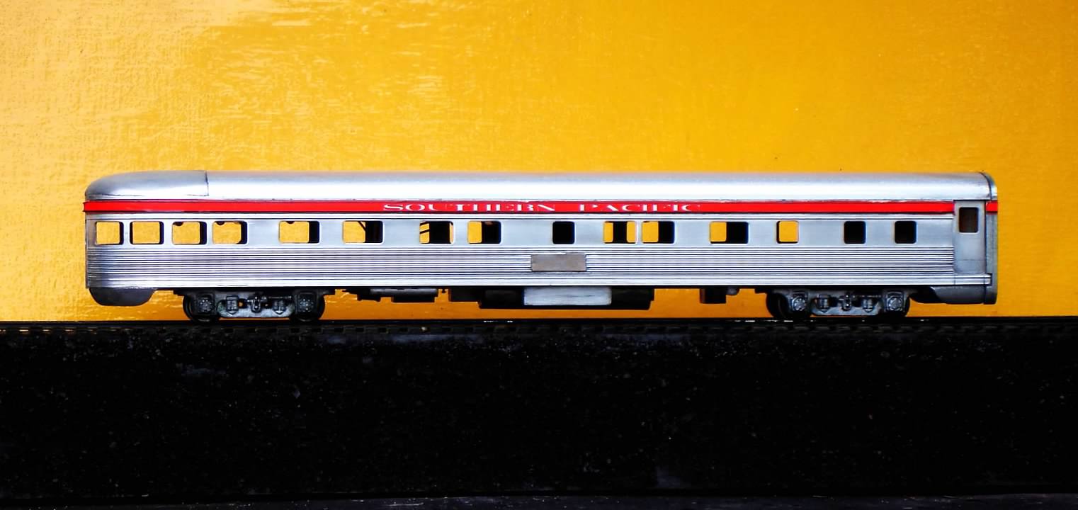

Meantime here are a couple modified Kasiner cars - this one is "Chart Pak" with Microscale decals that should have been coated with Future Floor Wax.
I generally shortened these to around 19 or so inches and re-did the door and letterboard areas. This is the Sunset color scheme, applied first only to Budd cars. Later on it was applied to everything, including the Pullman Daylight cars.

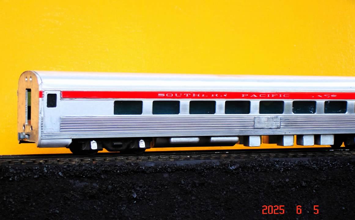

And the Kasiner Observation:
This one has the vinyl stripe with the SP legend already pre-printed. Next time I will have Callie reduce the width of the black, and make the stripe ever so slightly wider. You cannot tell, but she outlined the letters in black for me. I like the ChartPak red better, and am sure she can duplicate it for the next order.
And I bet she can do vinyl for those rectangles on the sides - I need to order some Milwaukee stripes as well, so soon . . .
Long time forumites will remember she did the chrome wings for my Milwaukee Erie-Built. Superb work!
A word on doorstop truck sideframes: For me, the only realistic Daylight truck was done by Lobaugh. The Obs has Commonwealth trucks, for some reason. And I do have a few of those "Hat" trucks with roller bearings, and today learned that they may be FV Shops products from 75 years ago.
