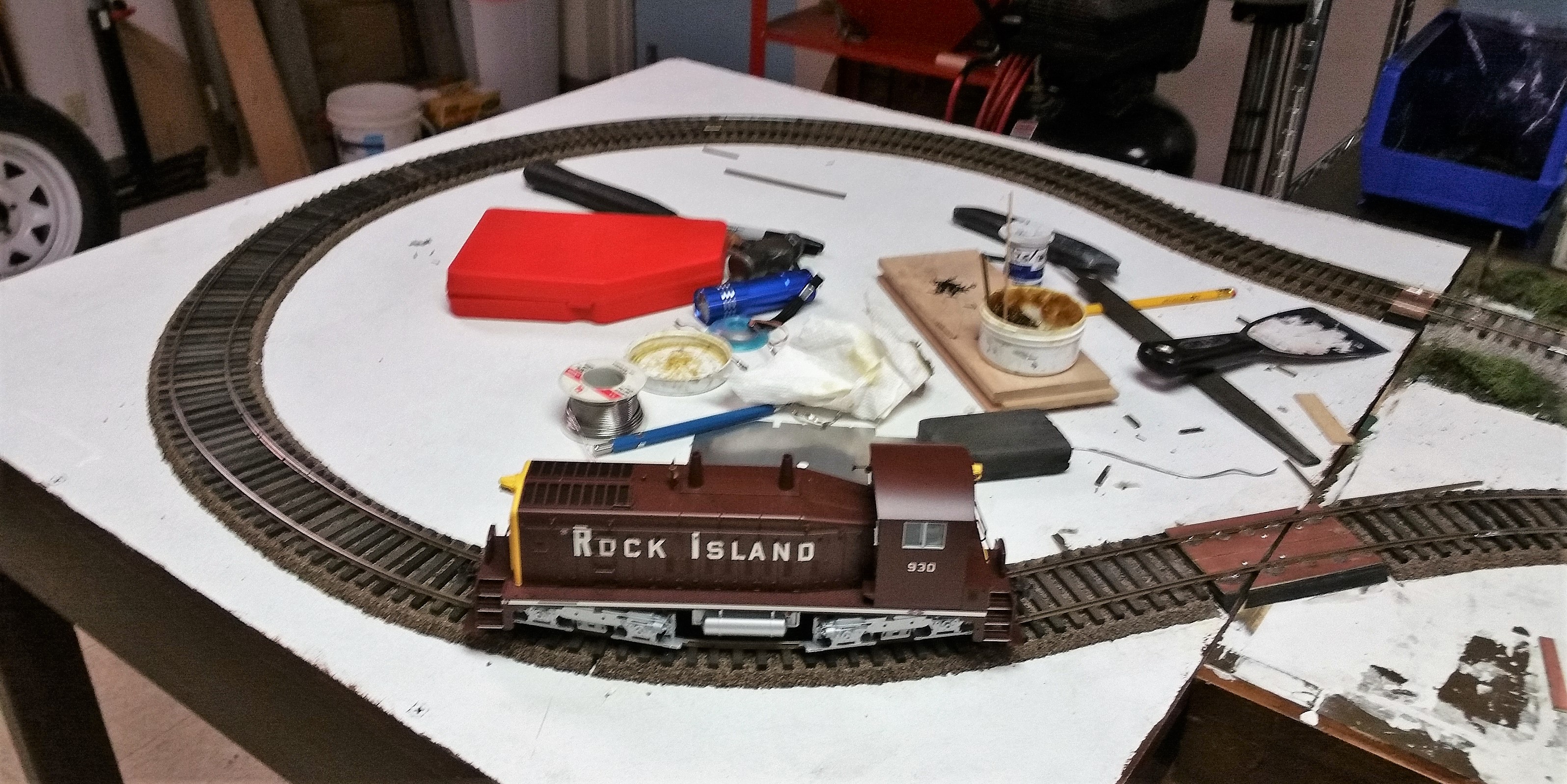

Now -- for an update on the traction layout. This Saturday was Week 6. The east loop is completely spiked down. We jumpered in a power supply and gave it a test run with an Atlas SW:
We don't expect to run such equipment on this layout (can you say "needs radial couplers"?), but it's all we had. For those wanting see what an SW looks like going around 15" radius curves, check out the video at the link below. You will notice the very conservative speed. Those curves are tight and it's a long way to the floor!

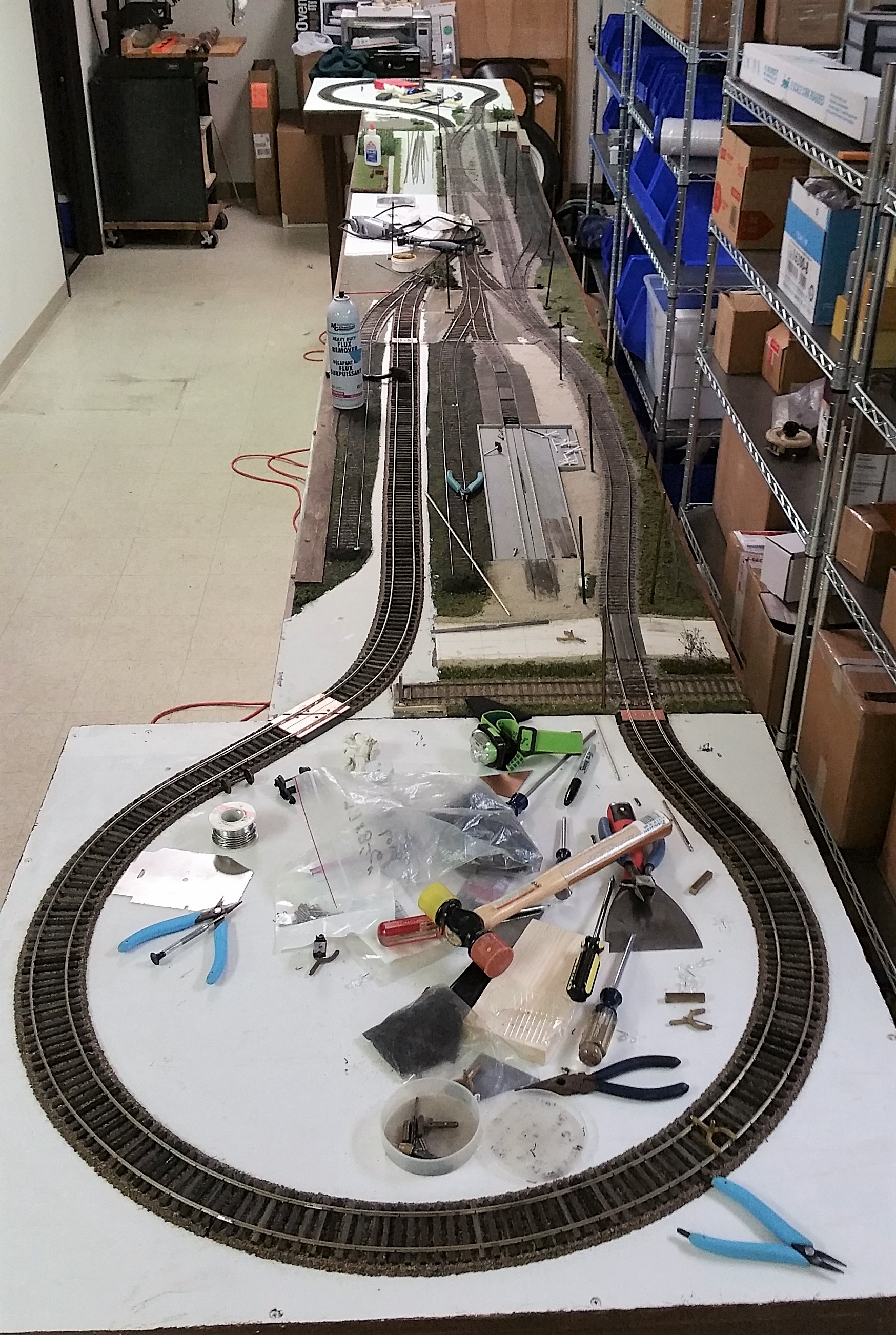

The west end loop is almost complete as well -- just a foot or so of rail left to spike:
One more Saturday work session and then the "Railroad Days" show at the Allen, Texas depot is the next two weekends after that. We won't have the overhead up for this first show but we have a couple of industrial switchers and a few traction models that can be run on two-rail, so we'll limp through the show that way. We then have the rest of the spring and all summer to get the overhead up and running. The goal is to have both this layout and our big mainline layout at the Ft Worth meet in October.

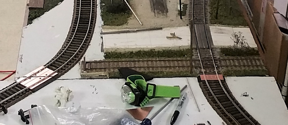

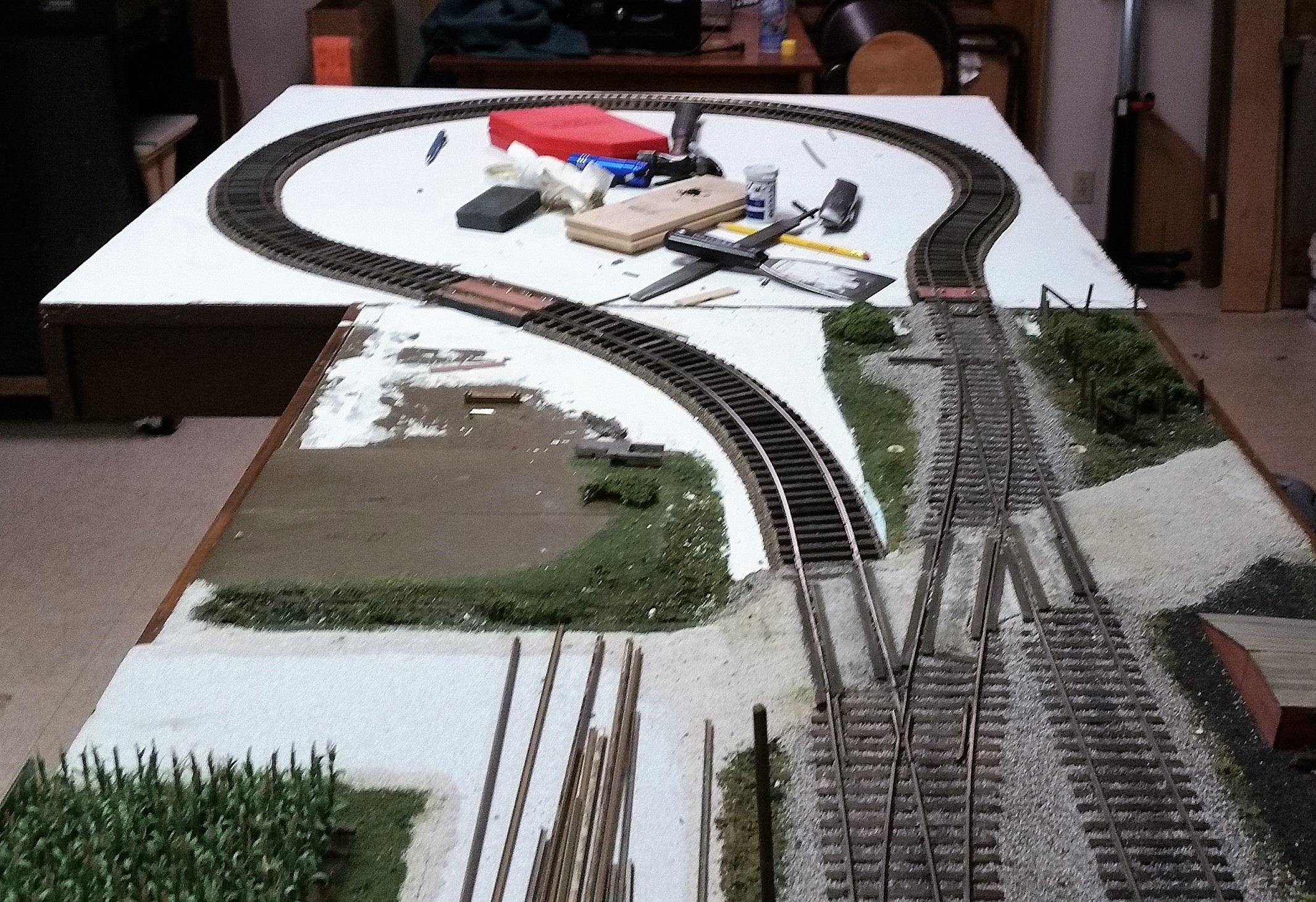

Are you going to continue the crossing in the bottom photo by putting another diamond on the left track?
- Posts: 3132
Re: DFW Portable Layouts -- Mainline and Traction
Dave -- As you can see by the light-colored area surrounding the left-hand track, we choose to demolish that corner of the legacy module to speed the installation of the mainline. The light colored area looks like the table top (and it is in the new module at bottom) but in the legacy area it's actually a skim-coat of drywall mud to level the foam deck, which got torn up a bit during the demolition.
In addition to removing the cross track, you can also see that we removed the parallel highway road as well. Scenery is not my department, but I believe the consensus in the club is to restore as much of this as possible. Restoring the track however will be complicated by the use of the circuit card under the mainline rail right at the border of the module. We normally only use a small circuit board, as shown on the right, but the unusually steep angle of crossing on the left required a large circuit board. The circuit cards are not very attractive, but we have had great success with them -- they hold the rail in alignment between the modules without the need for rail joiners. The trick with crossing at an angle is to cut the rail square with the rail. If you cut square with the module then you leave a point to pick.
There has been discussion of making the circuit board area into a grade crossing. That would be great if it worked out. We could also try to carve the circuit card up to look like there are ties there, but we have found doing that to be above the level of tedium we are willing to tolerate.
