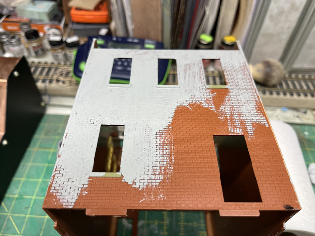

Here, we are have a Walthers Cornerstone structure, a decently proportioned building albeit glued together by Chinese labour and all in its original moulded colours with all the toylike appearance of some sort of modern over-the-top Plasticville. We're going to dial it 'waaaaaaay back to bring out the promising proportions.

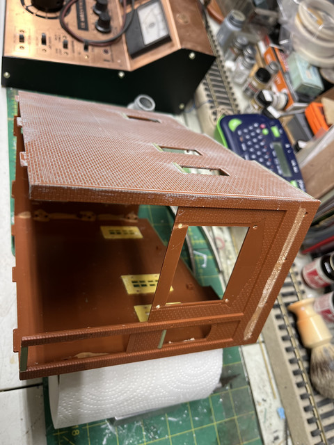

First, the blood-flow inducing disassembly chore. Ideally, the window frames, doorframes, and cornice-work, in short all the wood bits, can all be detached. In this case, these bits are all moulded in a truly hideous yellow. That will certainly be changed!
Once we have a stripped shell, or in this case as stripped as it can be without destroying anything overglued at Kader, we can both tone down the brick and fill the mortar lines as a first step to redemption. The majority of model railroaders want to dive right in with white, which again is far too stark a contrast. I prefer a medium grey if the mortar lines are to contrast with the brick. Far more brick buildings than you think have coloured mortar that doesn't contrast the brick, black mortar is common, and more than one might think are painted. Natural brick-mortar is grey. White is actually rare.

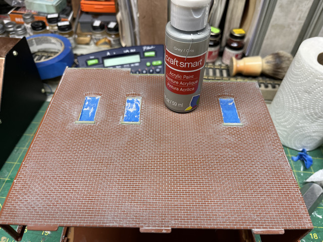

For grey mortar, a good 3/4 to 1" sable brush and some cheap grey acrylic is the route I take. I use it full thickness as it tends to be more even and opaque on a decent brick-moulding, and the relief on this thing is actually pretty good.
First, I just paint the side, making sure the stuff gets in the lines and you see no more brick-colour. Don't be shy.
Once the side is coloured, wipe it down with paper towelling. Paper is stiff enough it won't get into the relief of the casting, leaving the mortar lines. If it goes dry and starts fighting you, dampen the towel and the acrylic will become soft again.
The overall effect of the flattened, lightened, and weathered brick comes up like this, along with the mortar. If you missed a spot of mortar, just repaint and repeat the wiping off process. The blue tape covers the few window frames that couldn't be disassembled because they were over-glued in manufacture. They'll get masked and painted in situ. The bottle is the artist's acrylic I happened to have to hand. Craftstore item.
Here you can get an idea the improvement from the original raw plastic look.
