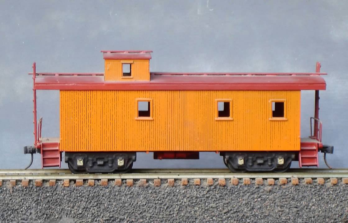

On a different subject, and not to clutter up other current posts - I may shoot some orange and chocolate on one of my steeplecabs - charming color scheme, and I have a matching caboose!

Those colors look great on IC and CGW locos.
