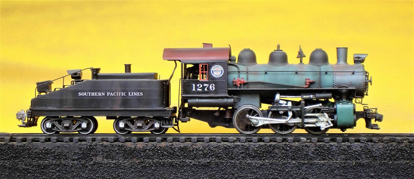

Here is a tender with relocated wheelsets. It doesn't seem like much until you study the unmodified Lobaugh truck in comparison:
