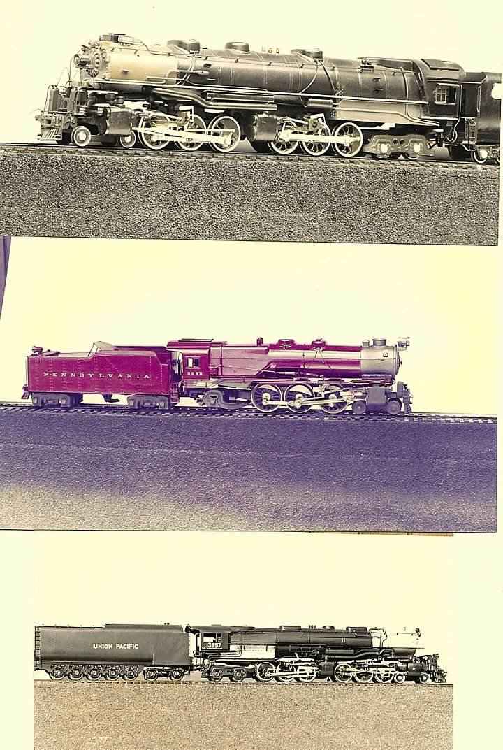

Er - here are three that escaped before I got a digital camera. Top is an early Challenger from Jake Bechtel - my first real O Scale Lobaugh purchase. It went to Henry Leslie in a trade that involved a rather junky, rusty later Lobaugh Challenger.
Middle is Frank Thomson's Mi-Loco K5. He hated the Tuscan, so it now exists somewhere in a rather lighter Brunswick green. These were not bad models for their day.
And last, the "last" Lobaugh Challenger - mentioned in my first post. It belonged to Jack Campbell, then was sold when Lobaugh itself was sold to Jan Lorenzen and a Los Angeles hobby shop. I paid a premium. It was originally built by Bill Darling, who gave me what I had paid for it to re-own it. We both knew it was overpriced from the get-go, although it ran well and had fully sprung tender and trailing trucks.

That early challenger is the nicest one I have seen. Nearly every early Lobaugh challenger in my experience appeared to be a significant project.
