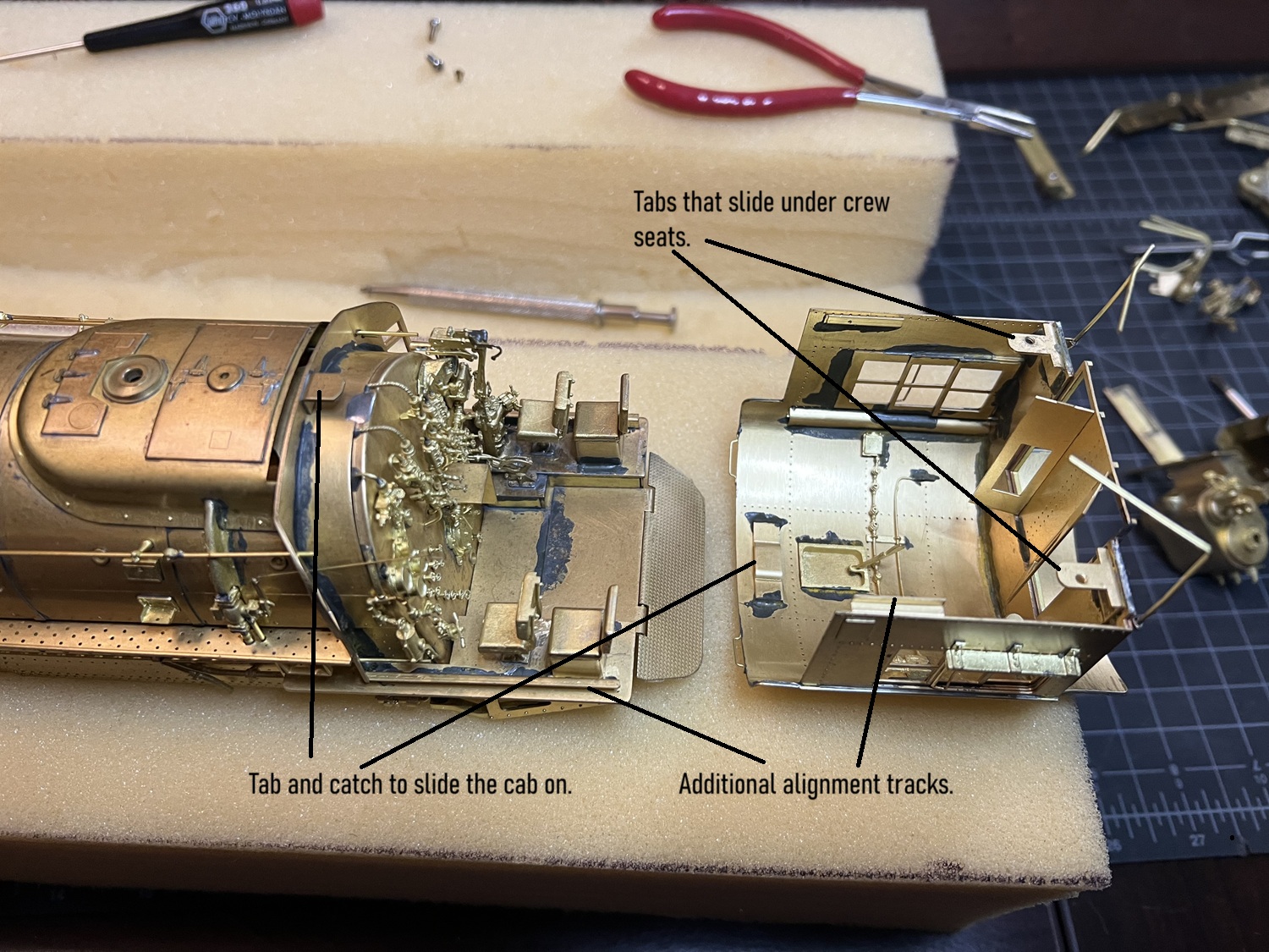

It's been a little dead around here lately, so I'll share a discovery I made today. As I stated before, I want to make some of the details functional (hatches, smoke box door, vents, etc.), plus give it a removable cab. But, making the cab removable was really above my skill set and was a project I wasn't really looking forward to attempting.
But, after being told by another modeler that he thought the cab was factory removable I removed the two screws under the cab and he was right. Typically these screws hold the crew seats in place like on other models I've I've owned. BUT, on this model, it holds the cab in place and once the screws are removed the cab slides backwards and off. Obviously I was thrilled.

Is the dark grey oxidized solder or JB Weld?
Ran into a GEM 0-4-0 in H0 back in the 70's, new, put together with epoxy.
And the ONLY thing that held the worm and worm gear engaged was weight of the boiler. And the boiler was steel, painted "brass". They "insulated" the open-frame motor with a piece of Scotch tape draped over the brushes.

That is oxidized solder which seems to be a calling card of KTM built locos. I've seen it quite a lot, but only on the KTM models I've owned.
Yeah, I've bought some models that had details reattached by glue. If only our models could talk.

What a beautiful model. Each new picture you post impresses me with the attention to detail the importer included. With your updates it’ll be one of the best Challengers ever. Look forward to how it progresses.

I can only hope Aaron. I've found some boo-boos that KTM made. Cab doors ought to swing out on Challenger and the model was built with inward swinging doors......I may have to leave that.
Interesting point. The water hatches on the tender are held on by a screw from inside the tender....not soldered.
