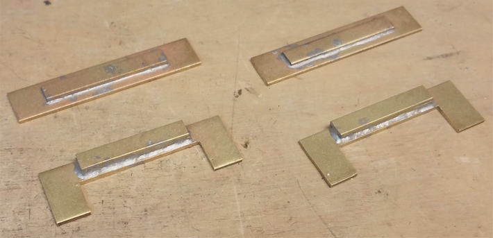

I started this thread with a question regarding the milling of some brass bar stock and the problems I was having getting a good clean cut. There were a lot of good suggestions, to which I thank all. I should say that I was not plunge cutting but taking very light surface cuts -- maybe 0.010 at a time (not wanting to break the small tool). I understand the idea that the tool RPM should increase with small bits -- I had the speed on maximum. It was suggested that the wood base I was using to secure the piece was simply not heavy or rigid enough, and I am thinking there may be some truth in that -- I used a piece of scrap pine instead of hardwood (and me with a bin full of scrap maple). However, rather than pursuing it further, I took Jay's comment to heart about not risking a fine tool to do work that could be done in another way. So I saw-cut the pieces and then finished them with a stout 1/4-inch end mill. I even found that simply using a disk sander for certain cuts was the right way to go. I have a small desktop sander with a miter guide that produces a surprising clean and accurate 90 angle.
I was cutting the bar stock as I needed two sets of chassis bolsters for an older pair of CLW Alco PAs. The later versions of the PA look like this:

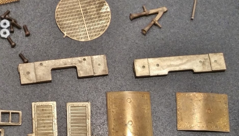

The cast pieces at the top center and top left are from a CLW FA chassis kit I have. These were helpful in thinking the project through. One of the completed pieces (less holes) is at the bottom left. I used my resistance soldering unit to join the four parts:
I don't actually own the pair shown (I sold the kit they were in last year), and the units I am working on are built a little bit differently (originally came with fiber bolsters), so I had to both design and fabricate my own. I could have milled them out of solid stock, but I decided to build them up instead from bar stock. In this photo, the four cut pieces are on the right:

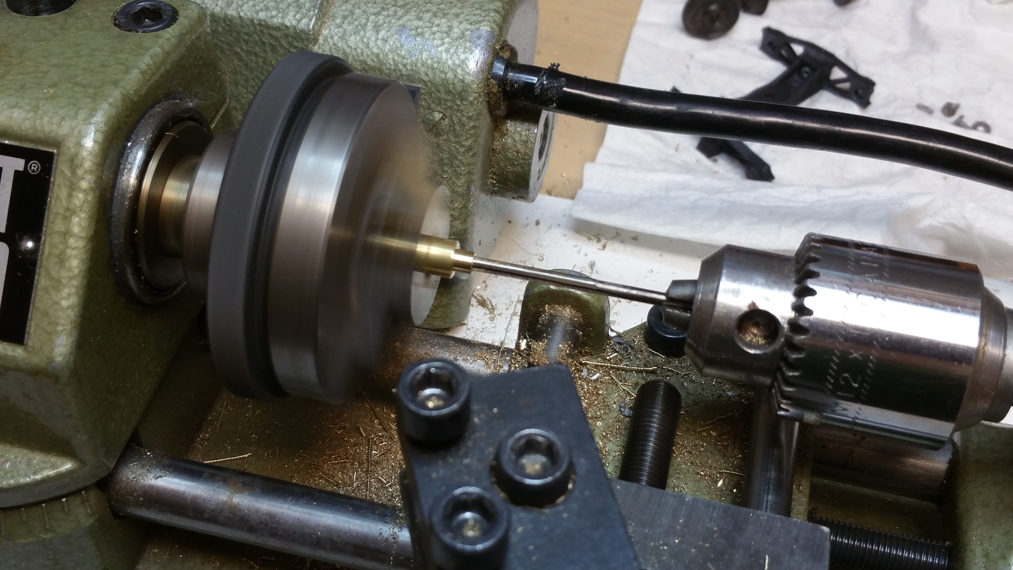

I have possession of a good number of Allan Wehrle's old machine tools, including a nice selection of "chucking reamers". I knew from my the machine shop days (of my mostly-wasted youth) what a ream was, but I had no recollection of the concept of a chucking reamer. A bit of internet searching confirmed what I suspected, which was that chucking reamers are designed for use in drill presses, mills, and lathes. Unlike a hand ream, which is what I remember, a chucking reamer is designed to be used as speed.
So a pair of Walthers cast white metal tender trucks arrived on the workbench recently with terribly rusted wheelsets. The axles were pointed, which I thought was common, but an inventory of my spare wheelsets produced nothing that would fit (the Walthers axles seem to be longer than Athearn or other similar pointed-axle sets). So I decided to spin some bushings and convert the trucks to straight axles. I know that brass is not at all ideal for journal bushings but I knew that this particular locomotive would not see significant hours of run time (not having a layout, none of my models ever do), and I had brass in hand, so what the hey -- brass bushings it is. There was a #41 chucking reamer in Allan's collection, which I calculate to be a perfect size for standard 3/32" diameter axles (which might explain why Allan owned it), so that gave me a chance to try it out. Here is a closeup:
I drilled the stock out a few thousands undersize and the ream work beautifully. I didn't expect trouble with soft brass but you never know until you try it. As an aside, the lathe is a Unimat that belongs to the club. I have a Taig that originally passed through Sarge's shop before landing in Texas that I really like, but for very small pieces the Unimat is a little easier to use -- especially when it comes to getting those easy-to-drop items chucked up.

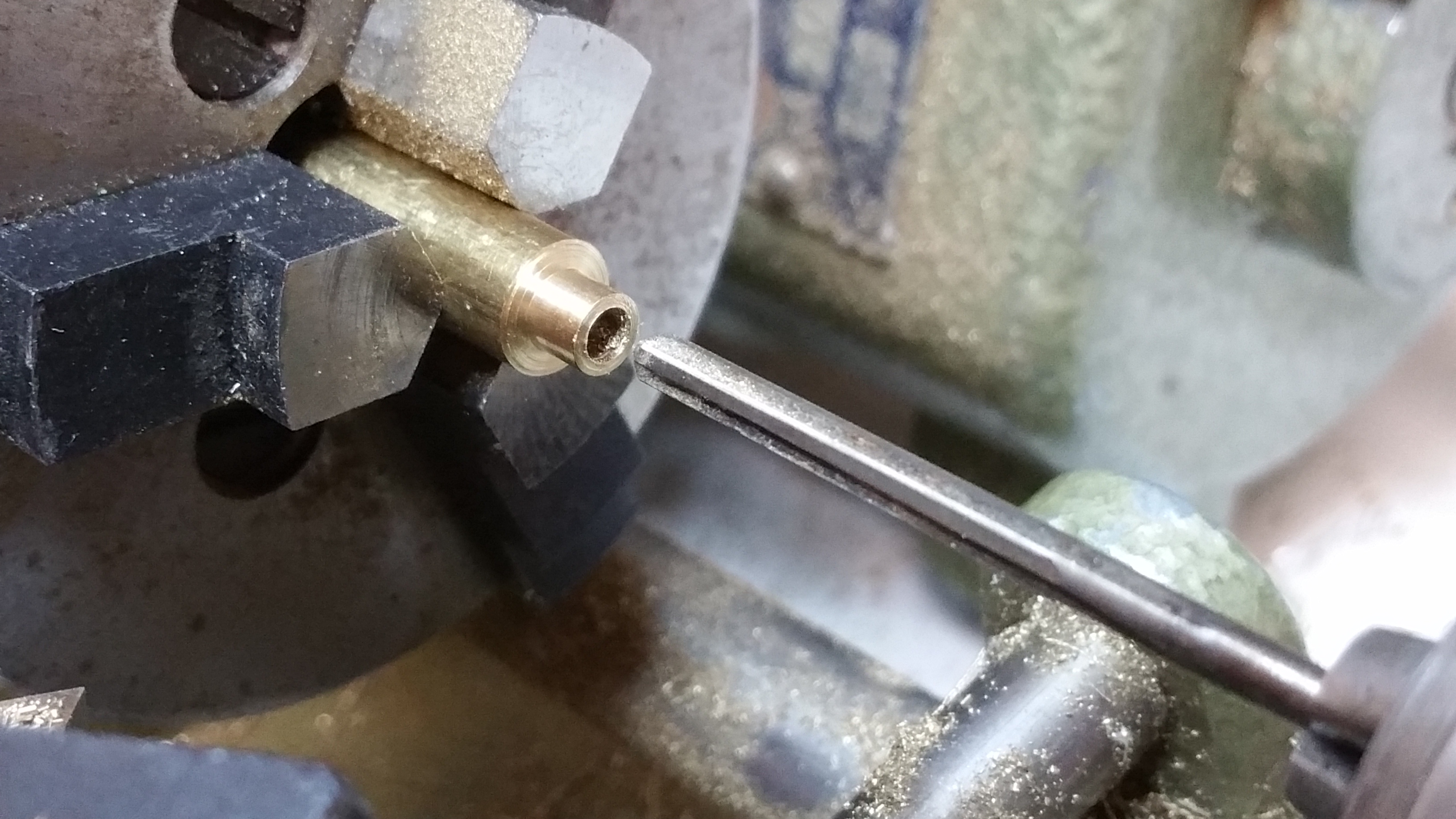

Here is one of the sideframes with one bushing pressed in:
I cleaned up the journal holes with a twist drill (and increased their depth a bit), and then sized the bushings for a friction fit into the sideframes. I did not see a need for a true interference fit. Note that I put a slight taper on end of the bushing. This made it easier to start and also provided some relief for the drill angle at the bottom of the journal hole.
It all looks relatively simple and straightforward, and it is. I imagine with a turret lathe you could do several in a minute and that an automatic screw machine could do a hundred a minute, but to do eight by hand with a standard lathe took me a couple of hours. The next eight would go much faster, of course, but I only needed eight so that's that.

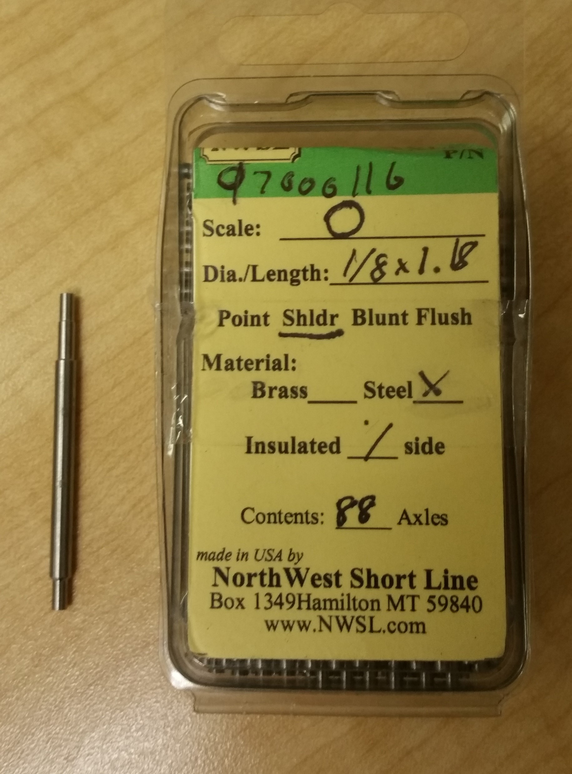

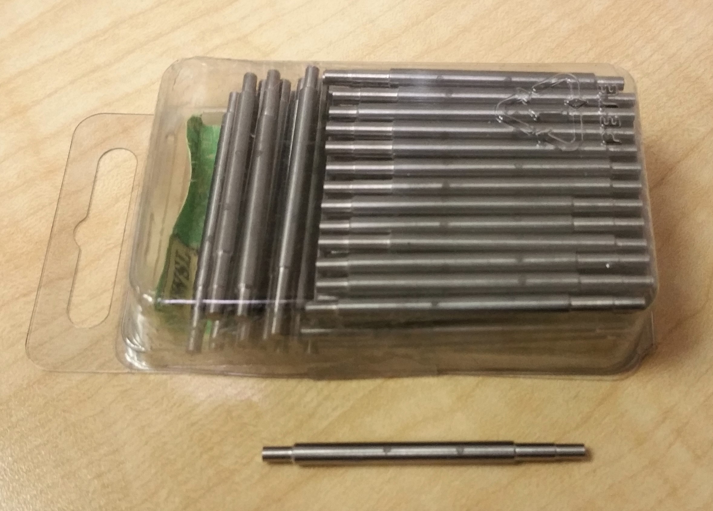

I imagine many of the old hands here have ordered axles from NWSL at one point, but until recently I had not. Their catalog has A LOT of different axles listed, and I always wondered if they kept them is stock. The answer is no. I placed an order for quantity 88 shouldered axles of the type commonly found on their passenger car wheelsets. It took two months for them to arrive:
I bought these to replace the pointed axles that came with a good number of surplus NOS NWSL wheelsets I picked up cheap a while back. I need to gin up a gauging jig for pressing the wheels on, so if anybody has some suggestions I am all ears.

I usually make my own anymore but one of the tools I find very handy is a gauge block. I will attempt to attach a link to the P:48 versions I sell through Right-O'-Way. I wasn't sure if I should post this but, because what I have is for P:48 the actual part doesn't apply to what you're doing. The concept does. For regular O Scale I made one from 1" Delrin rod. Use the lathe to cut to length and the mill to cut out the slot.
http://www.right-o-way.us./manager/imag ... C-106G.jpg
There is more to the actual assembly and I'd be happy to share how I do it.

If you lathe is equipped with a set of headstock collets, making bushings and axles is pretty simple. I use drill rod quite often to make axles.
I have made a lot of very small parts over the years on my 9" South Bend lathe including some very small threaded (0-80) handrail posts by holding the work piece in a collet. It is great to see you enjoying the use of your machine tools. This kind of work is how I spend a good deal of my hobby time now.
Joe
Joe

Jay -- Thank you for posting the photo. I actually have a short piece of 1" Delrin rod (somewhere), so I am very interested in the gauge block. There must be some trick to how you use it as it is not obvious to me just by looking at it. So if would, please share the assembly details and I will give it a try.
rrjjf wrote:If your lathe is equipped with a set of headstock collets, making bushings and axles is pretty simple.
Joe, my Taig mill has a small collet set in common fractional sizes:
These are absolutely great for holding cutting tools. However, my memory is that the chuck for these does not fit the spindle on the Taig lathe. I may be wrong about this so I will double check. I can see that having collets for a lathe could be very useful for making multiple copies of the same part.

The collets will give you the accuracy needed for making axles that you'll never get with a 3 or 4 jaw chuck. You may need a collet holder for your lathe. I assume Taig, or some other after market company, makes them. Run out is your enemy.
