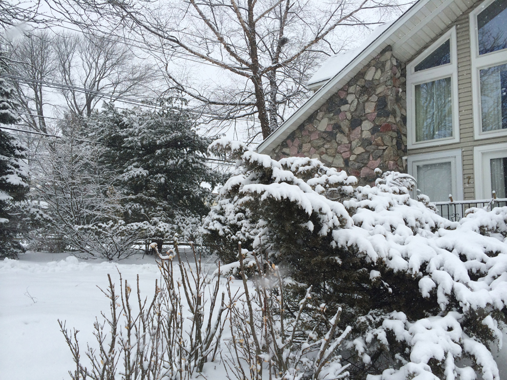

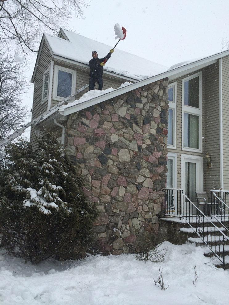

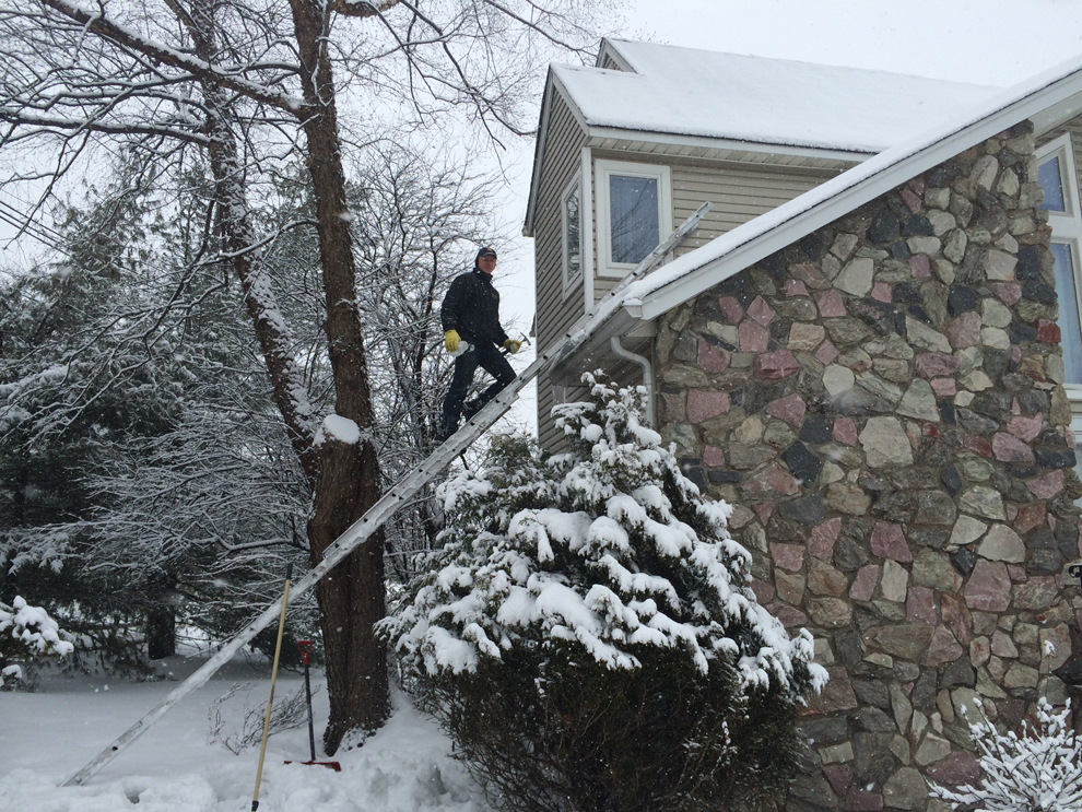

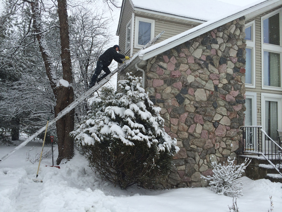

Here was today's project. A leak had developed just under that window in that little tower and traveled down through the powder-room (inside that stone wall) and proceeded right down into the basement, falling at a pretty good clip just 4' from the layout. Instead of just freaking-out, we dragged the ladder out (not without a struggle, of course!) and the 9" build-up of cement-ice had to be chipped slowly and carefully away with a bricklayer's hammer. Altogether, it took several hours to shovel that sloped roof and to remove all the ice. Now comes the clean-up inside and the drying-out of walls, carpeting, and storage stuff. I have some portable heaters and much patience.
But I am real, real tired-out. Yup.
- Sloped roof 9" ice-jam under window
- mar52015_edited-1.jpg (786.78 KiB) Viewed 5198 times
- paulup3.jpg (751.17 KiB) Viewed 5195 times
- paulthro.jpg (628.02 KiB) Viewed 5196 times
- bricklayerhammer.jpg (709.31 KiB) Viewed 5195 times

Murph,
Tell me that is NOT you on that ladder and roof.
Remember I don't see real good.
